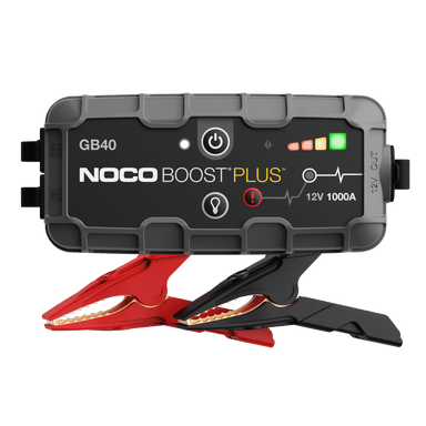

Here is my new NOCOBOOST PLUS GB40 - Wonderful product it will hold it charge and boost a car for 2 years. Can also be used to charge any electronic equipment that has a usb charge option. It is 12v 1000 A and you can see how small it is. Will store in the rear of the Santa Fe in the under floor storage of the Cargo area. It seems someone at church or somewhere is always needing a jump and this will also provide a wonderful way to help them
