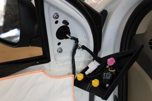

Sure thing, I took a picture of it, I will post it tomorrow when I get a chance.
#17 ·
The orange, yellow, and blue wires are for the mirror motor. The green one the end is the signal. And there are red and black wires on the underside, red is defroster, black is ground.
