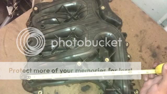

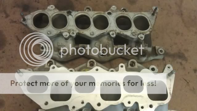

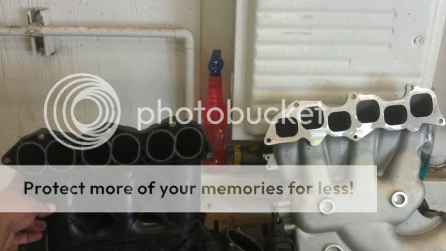

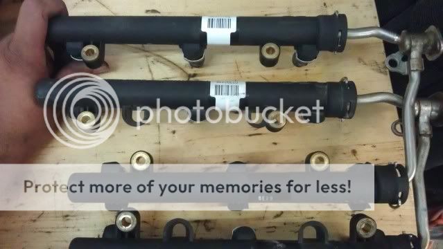

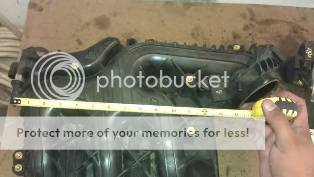

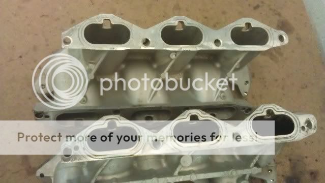

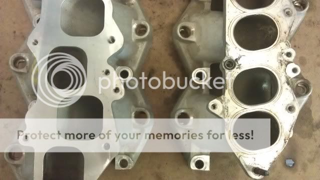

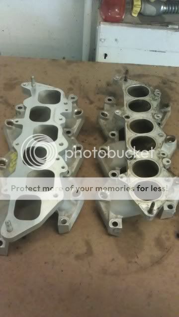

The issue i ran into is that even though they look very close to being perfect fits but alas it will not work right off. the fuel rail mounting points for the sonata are about 1/4-1/2 inch on the rear rail too long and nearly a whole inch too long on the front rail, also the hard pipes that connect to the rails is just slightly a bit too close for the upper intake to mount just right so ill be getting the fuel rails and fuel line assembly soon to. but other then that i still test mounted the new intake and it will fit just fine although it is a bit taller then the stock unit thus there may be an issue with trying to re mount the dsm upper strut bar. sorry i dont have any pics of when i mounted it but my phone died but anyways here are some pics an a vid of the 3.8s
#18 ·
hah so you gonna join me an take the plunge on one two?
oh yea you can see the difference also the pics dont show it as well but there is a good difference between the angles on the lowers on how shallow and sharp the angles are between them. also the injectors fit a bit tighter in the 3.8 but they mount in just fine...its just the mounting points for the fuel rails that differs

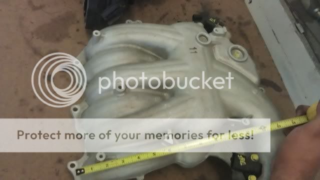

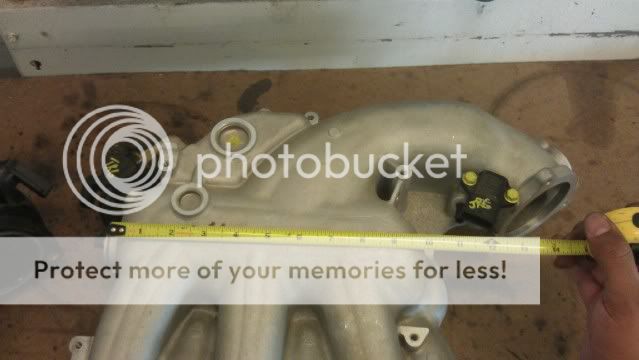

oh and here are some pics and needed parts
azera 3.8
Upper Intake Manifold
Lower Manifold
Fuel rails/Injectors....hah the one my set came off only had 45K miles on it so yay newer cleaner injectors hah
pcv gases nipple(part#292123C300)
Manifold gasket (part#29215 3C301)
left and right bank lower intake manifold gaskets
(part#284113C612 & 284113C622) now you dont need these but i changed mine since i just hit 90k and the oems were burnt
Throttle Body gasket( I got mine from FELPRO since the dealer wanted $22 for it vs $8 from them)
part#61560

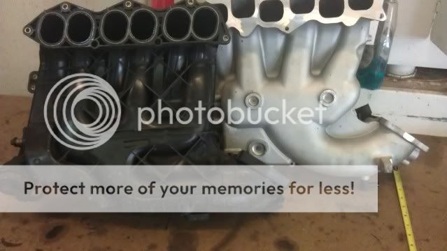

The one on top is the azera 3.8s the bottom is the stock NF 3.3 ones
and this is it installed
