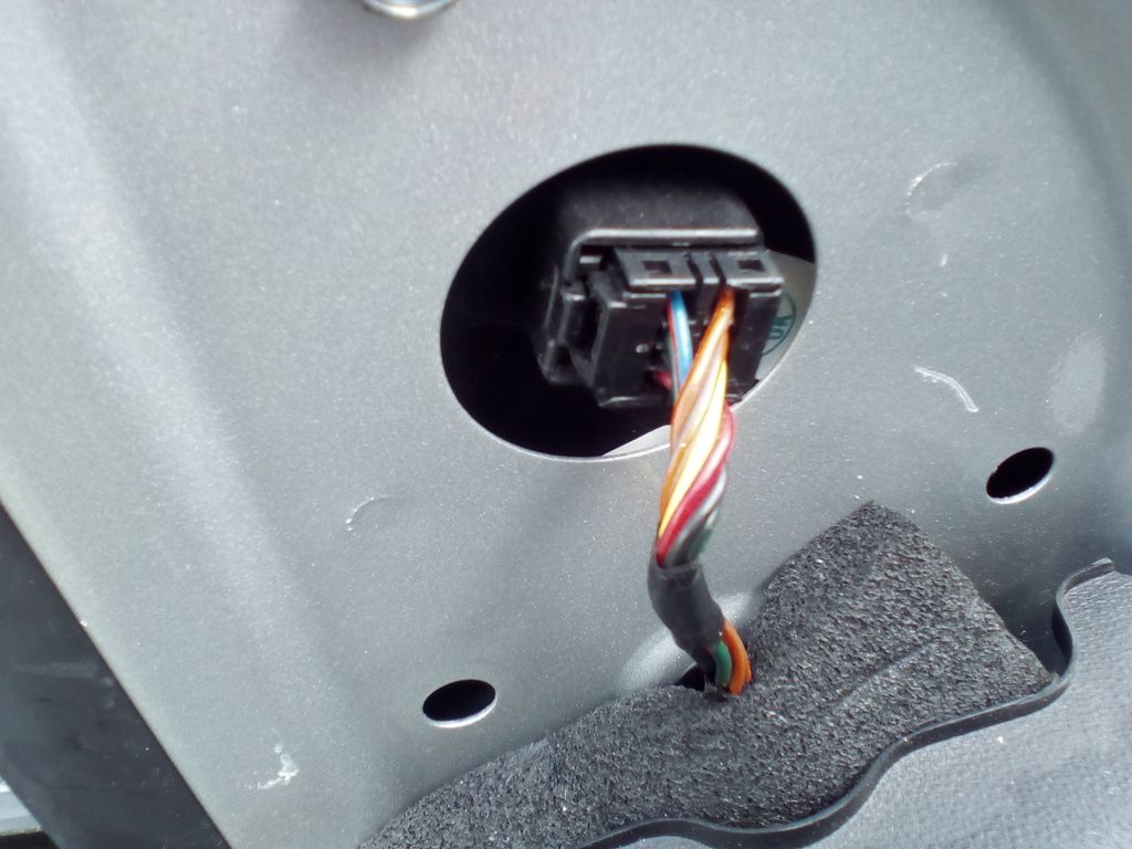

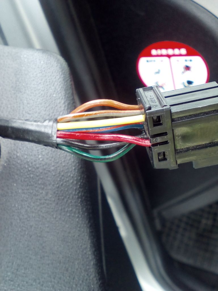

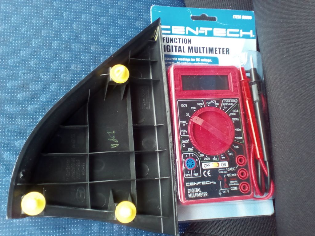

On Hyundai mirrors there is usually a connector behind the little triangle trim on the inside of the door that covers the mirror securing bolts. The first thing to do would be to count how many wires are on the connector. The folding mirror motor will need 2, the heating element will need another 2 and the mirror adjustment motor will need 3, so if you only have 5 wires there isn't any adjustment motor...or possibly no heating element.
Next you'll need to ID which wires are for the fold motor. Without a diagram that will be a process of elimination. A black wire will almost certainly be the heater element ground, and the heating element supply should be easy to find by starting the engine and switching the HRW on. Next find the 3 wires that have voltage when you move the mirror adjuster around. The two wires that are left must be for the fold motor. Connect a voltmeter across those to and work the fold switch and see if you get any voltage.

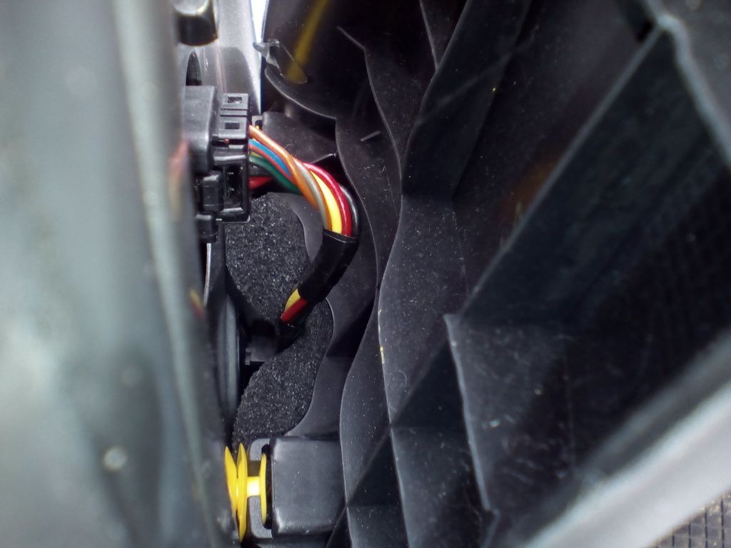

could this also be a issue similar to the skoda's, where the wiring loom fractures / breaks in the bellows (flexible) section between the door frame and the door
Yes, it certainly could although it's not a common issue on Hyundai cars. In fact I've never personally seen that happen on a Hyundai and I was an auto electrician in a Hyundai dealership for several years.
