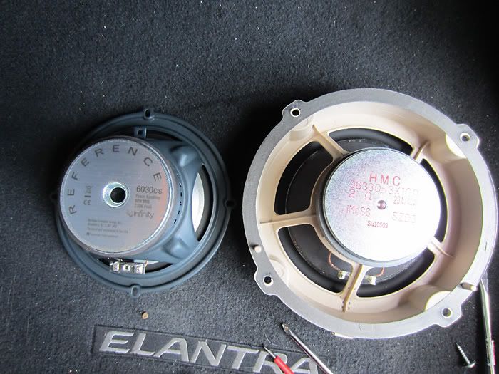

Woofer's comparison

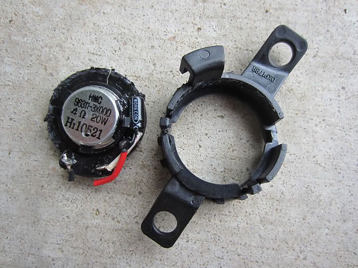

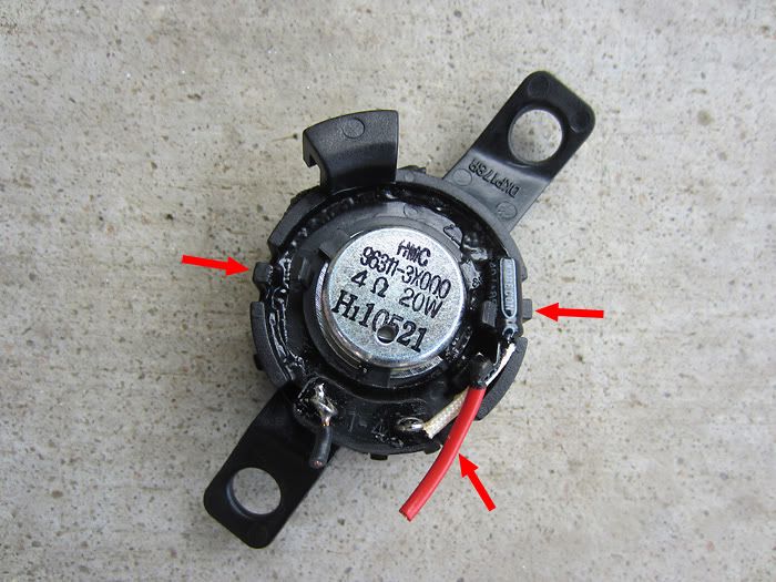

Stock Woofer removal:
Only hand tools were used
Diagonal wire cutter, used to cut and seperate the speaker's brackets
Scissors, to trim the rubber surrounds from the speaker cone (left the rubber surrounds to help cushion the Infinity woofer)
Infinity Woofer installed to stock speaker spacers
Only 4 drilled holes were needed for mounting. Speaker adapters were not used.

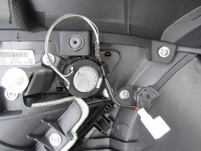

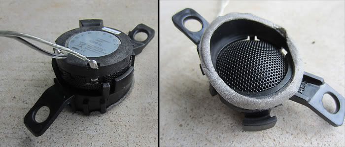

Stock vs Infinity tweeters installed

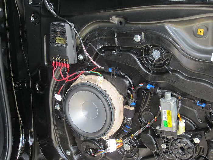

Infinity tweeter and Crossover installed
Input wiring using the factory tweeter connector removed from the tweeter as input to the crossover. Only the tweeters door wiring is used as input, the woofers are disconnected. The factory system does not have a dedicated signal to the woofer and tweeter. Infinity woofers wiring is tied to the center connectors on the crossover.
Space and location for the crossover was perfect.
Woofer installed

What did you use to mount the crossover?
I used several strips of 3M emblem tape. Both the crossover's backside and the door panel are flat in that area making it perfect.
