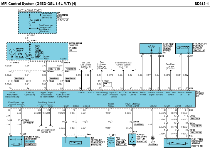

I'm assuming then that there is an open somewhere in the sensor wire between where the new sensor plugs into the harness and where ever it goes, maybe ecm. Do you have a diragram autospark?
Well done for managing to properly diagnose the cause of the speedo failure. It's just a matter of figuring out where the wire has gone open now. Sorry but I don't have any diagram specific to your model. Perhaps if you PM ikilledbarbie he will be able to help you out with that. He's the forum's MC Accent guy.
Us auto sparks often have to diagnose faults on cars without any diagrams though. There's no way you can have diagrams for every car that's out there. The way to trace the break is to simply probe the speed signal wire with your voltmeter at accessible points along the harness until you get a voltage reading. Once you have voltage you will know the break in the wire must be between the last two spots that you probed. More often than not you usually end up having to do it that way even when you have a diagram if you want to pin point exactly where the break is.
#37 ·
If I knew which pin it was on the main connector on the ECM, I would just run a jumper wire from that to the point where the new sensor wire connects to the main harness on the right side of the engine. I think it goes into the wire bundle that goes across the top of the engine that you have to take loose to get the spark plug coils out. I haven't been able to spend alot of time with it because of a chest cold but will try to track it down. I'll probably be so fed up with it at that point that I'll sell the car. Tired of replacing coils. Got one of the replacements from the Ebay seller I got the original 4 from, and bought one from O'Rielly's today to get it running again. The plan is to buy two more from O'rielly's and then send the four back to the Ebay seller for a refund. The original one from O'Rielly's is still working. I also replaced the spark plugs with regular cooper type that several have suggested to do. Leaving the top plastic "make it look pretty" cover over the valve cover as others have said the coils will run a little cooler that way. Can't hurt. It was interesting when I called the Hyundai dealer and talked to the parts guy. He said he sells coils all day every day for the Accent. I talked to a woman service adviser and she said they aren't a problem. Who to believe. haha
