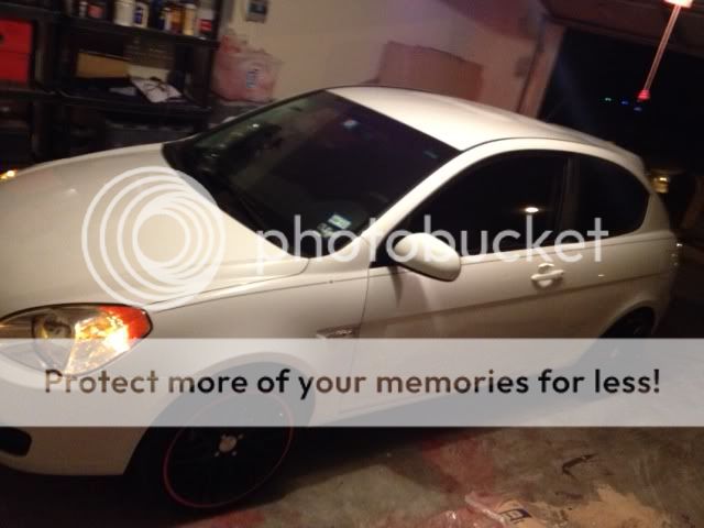

clean the lens with soap and water
Then wet sand it with dish soap and 1000 grit sand paper
then wipe down with paint thinner, then wipe off
spray 1 layer of VHT tint (going across and back with 25% over lay)
wait 5 minutes
Spray 2nd layer ect...
then wait 10 minute before applying clear coat
Ect
Then softly wetsand again and used compoun, polish, and wax

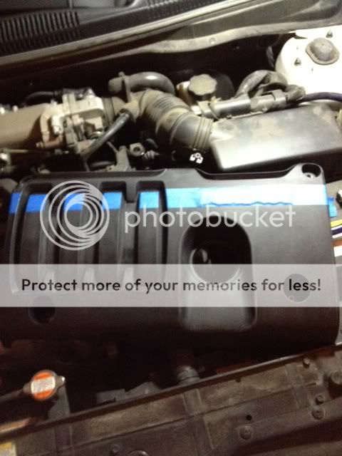

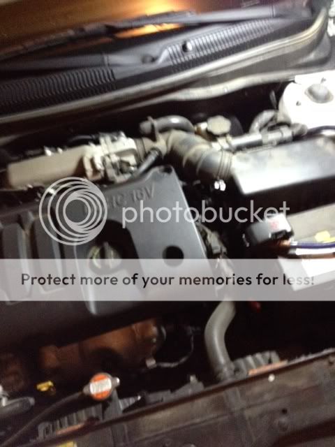

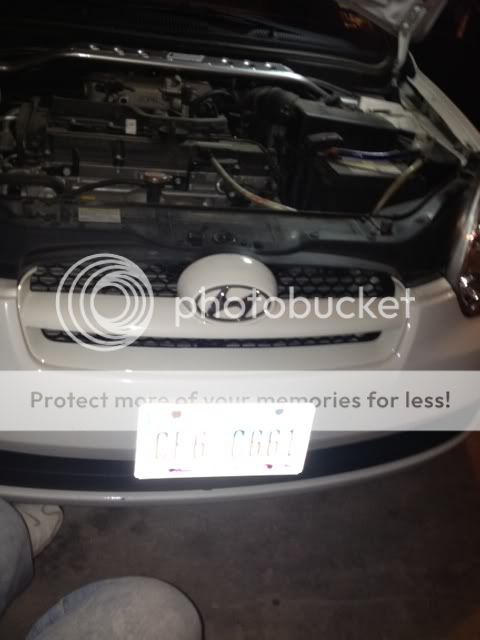

Nice car! Quick question, how exactly did you put that filter on your intake hose, since they stopped making the AEM SRI, I've been looking for something similar to that but I was afraid I would clam the hose shut or something.
went to autozone and got the 2.5-3 little red hose... and the filter... 35 bux. done
firts perfectly
