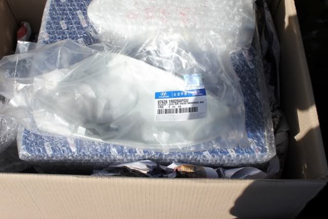

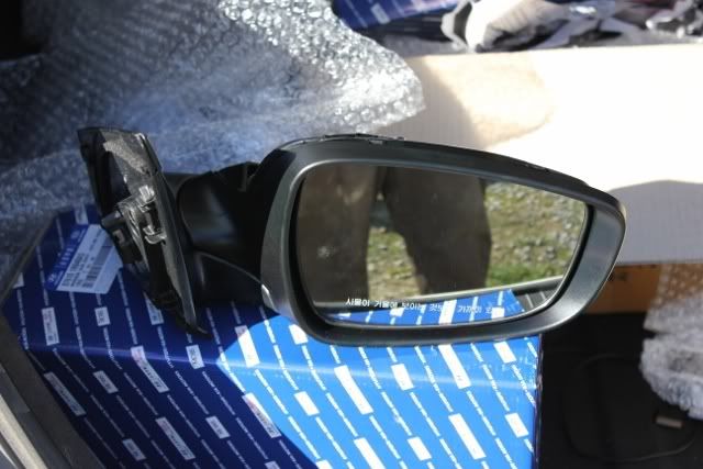

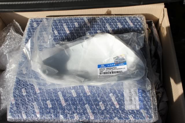

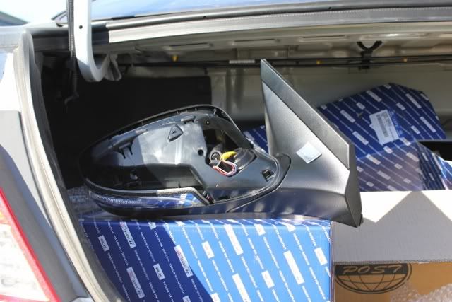

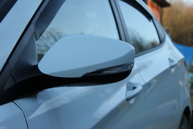

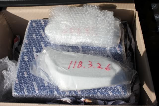

THEY'RE HERE!!!!!!!!!!!
I couldn't wait, so I put them on this afternoon. And they are Plug-n-Play! Unbolt the old ones, bolt on the new ones. I took it one step further and switched the mirrors so I wouldn't be looking at Korean symbols every time I look at them.
Basically, push in the inner side of the mirror (so its like pointing inward toward the car), then get your fingers in between the back of the mirror and the housing, then give a GOOD yank. It takes quite a bit of force to POP the mirror loose. When you push the mirror back in place make sure you get the clips lined up right.
Everything was perfect on arrival, and here way faster than expected.

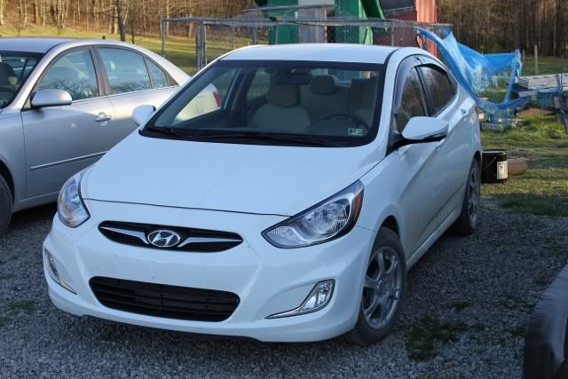

#42 ·
No heated mirrors, but is looks like the wiring is there for the Auto Folding feature thats also not alvailible on the US models.
I have to say that on my way to work this morning, I felt a whole lot safer, knowing that people have a better chance of seeing my turn signals since they are up and away from the headlights.

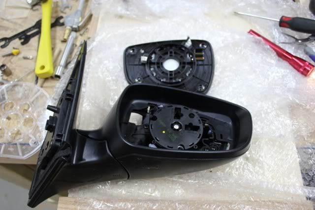

I just had my side mirrors retrofitted with an OEM Side Repeaters. All you need is an OEM cover & OEM Led Repeaters.
You can get it from this guy. I know him, his young and very nice to talk with. And you can trust him.
Hyundai 2011 2012 ACCENT SOLARIS Side Mirror Repeater Lamp + Cover 2EA OEM Parts | eBay
And since wiring harness isn't available, you can purchase a 2 PIN JST connector, in w/c I got mine from ebay also:
10 x Micro JST 1.25 2-Pin Male , Female Connector plug w/.Wire | eBay
You only need the female JST Connector. We will need it to plug it in into the LED Repeaters. Negative & Positive terminals on Repeater side is labeled but was too small. Make it sure you inserted the JST connector in the right direction. Also, on my case, I have to shave off the guide slots on the JST connector. Make it sure also that the wires leading to the LED repeaters will run through the rubber seal. If you failed to put on the rubber seal, moisture could get inside the repeater, esp. on cold/rainy days... You don't want to see moisture on those beautiful LEDs...
Next is you need around 1 Ft. of gauge 18 or gauge 22 wires (2 colors, of course of your choice, one is for positive, and the other is for negative), then we have to look for male socket pins. Please see picture below
Then, I will attached the installtion process in PDF. I prepared it to my customers here in the philippines. I have retrofitted more 20 plus units on Elantra & Accent. Elantra MD is a bit tricky, while our accent would be a bit easy...
