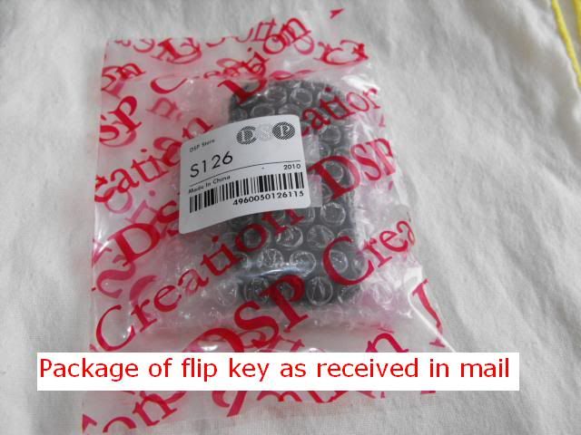

First let me say that I am by no means an expert, but I have some experience with flip keys and thought I’d share my experiences to help those who are looking to take the plunge.
Flip keys for Hyundais seem to be quite popular on auction sites. I’ve really only dealt with one vendor, so I do not have any opinions about other brands/stores.
The flip key style I will highlight is the model with two buttons. My Hyundai Accent OEM fob actually has three buttons, but I decided to hide the panic button because of the lack of a model with a panic button AND a battery holder. Personally I think the flip key looks a bit cleaner and the battery holder is very convenient to install.
The following pics are meant to serve as a pictorial for forum users who are interested in learning more about this simple (for some!) conversion to enhance their ownership experience.
In Canada our keys have ignition chips, and so one must access the chip to place in the flip key module. Those in the USA simply need to use a good copy of their key and insert their fob inside. Pics are from different models, in case those eagle-eyed readers spot differences.

So here you go with my pictorial on the flip key for our cars – I’m sure you could apply the pics to other models. Please post any of your own pics or questions, and we’ll try to help each other out.
