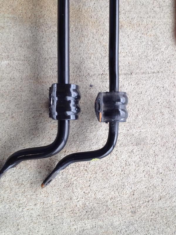

I've installed the SE bar on my 2011GLS, and the Optima SX version on my 13 2.0T Limited. Both are easy bolt on, just a slight diameter difference. I think parts dot com is where I bought them. Might have been rockauto? About 90$ shipped in both cases. Might as well go with the bigger SX bar.

Yes, they are the exact same. Just order the Optima SX sway bars. I installed it was like factory fit. You will need some clamps to hold in place as they are very tight. 18.3mm should be rear

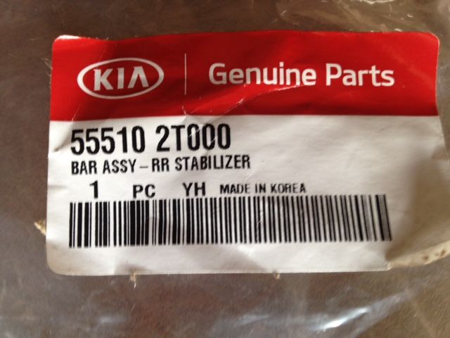

So the 2011- 2014 Optima SX rear stability bar is part# 555102T000 and it's 18.3mm. Correct?
