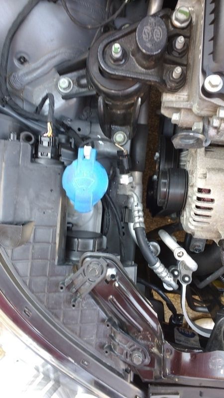

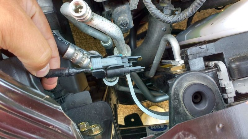

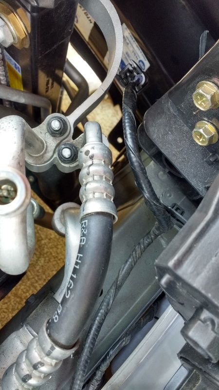

You have a missing part on your car. I happened to check under my hood and I saw something there that you dont have. I would say outside temperature sensor since yours says "--".
I have a 2012 canadian GLS. See pic below.

That circled item is a bonnet/hood switch for the alarm! They have replaced the radiator support and not the switch. It is normally mounted on a bracket with two 6mm bolts under the top left side of the body/radiator support>
RADIATOR SUPPORT for 2014 Hyundai Elantra
Missing part is No 20 here>
ANTI-THEFT COMPONENTS for 2014 Hyundai Elantra
The ambient temperature sensor is behind the front plastic bumper in the of the body/radiator support. Part No. 9 here>
I am guessing that the temperature sensor was not replaced or else not connected after the repair.
hope that helps.
