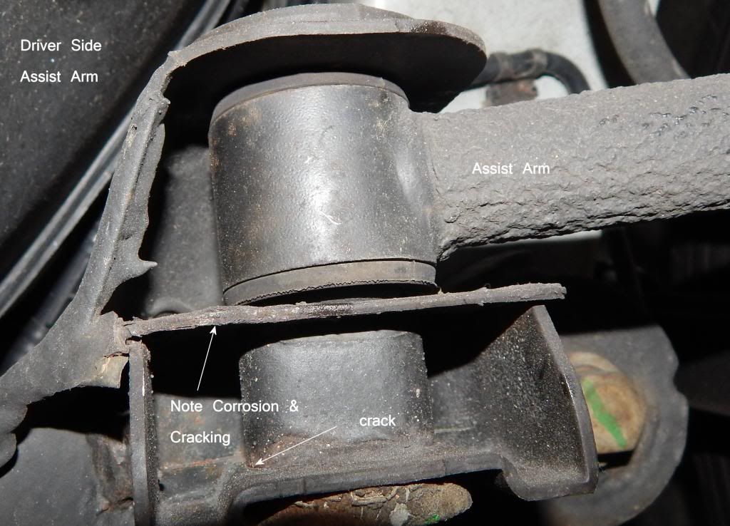

My wife's car has some serious problems with the rear suspension. At slow speed not much is noticeable. But at higher speeds the problem gets much worse and the problem has gotten significantly worse than from the beginning of the year when i first noticed a problem. What happens when you are at speed and hit a bump, it feels like there is NO lateral stability. the back end literally is floating back and forth in lane. It does not feel very comfortable or safe.
I had been investigating the source of the problem even before the recall for this problem came out. First let's start with the driver side of the rear suspension. I have some color coded diagrams in the overall Recall thread for this .
The suspension in its entirety everything is labeled.
Here you can see a detail of where the assist arm attaches to the cross member. There is a lot of corrosion and some visible cracks even visible in the pictures.
Its a bit hard to see in the picture, but it seems like the spacing on both sides of the bushing for the assist arm is NOT even.

Two more from the driver side, first the assist arm
But there is a lot of corrosion and a crack around Lower Control Arm too

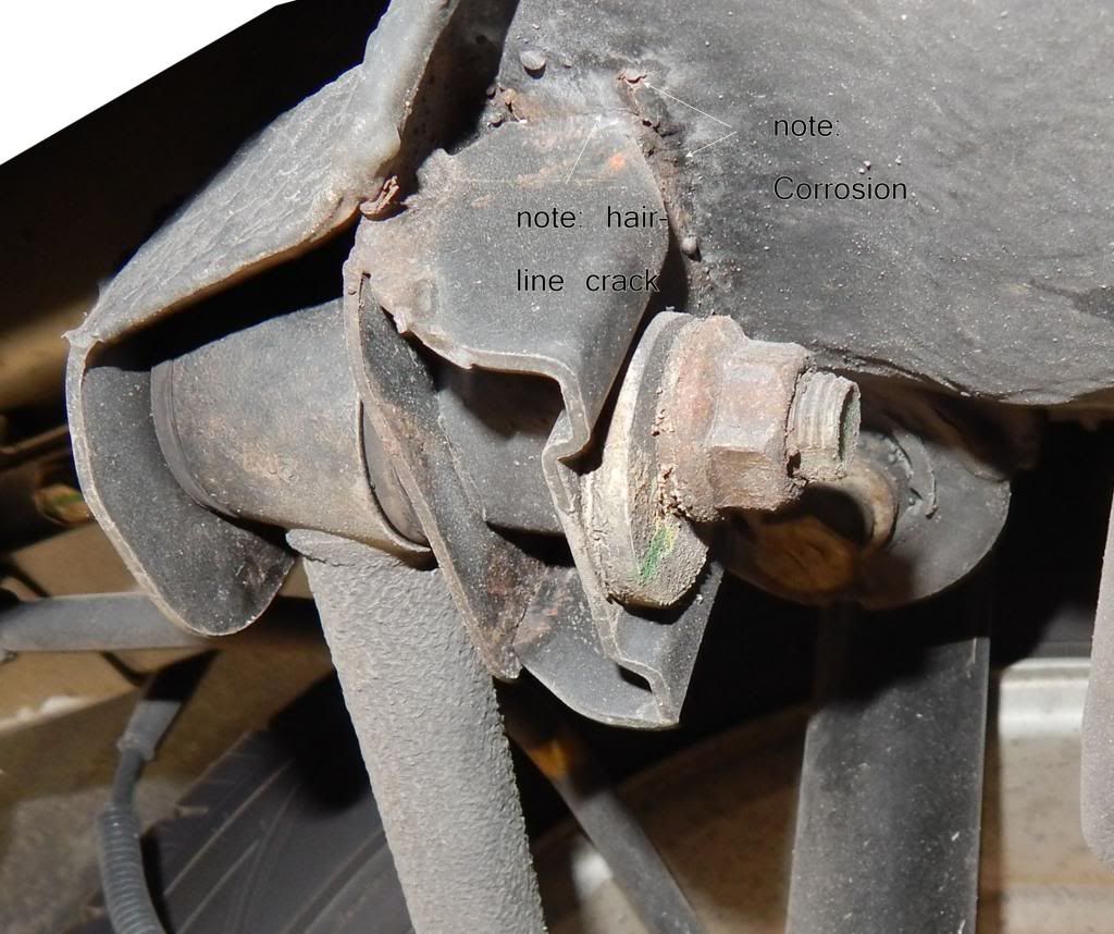

Now on to the passenger side, everything is marked on here
Note really bad corrosion and crack (photobuck may limit to how much you can zoom to see it)
Summary: I think the bottom line is the corrosion and cracks near where the assist arm connects to the crossmember are causing all the problems. The assist arm is what is adjusted to limit rear suspension toe-in. After a bump it seems to really flex and a sharp change in toe-in angle. As a result the rear suspension is very squirrelly.
This car is going in on Wednesday so i will report how things go. With this damage the BETTER replace this cross member. One drive will confirm that. I am assuming that an alignment will be done too. I want to know if they will also replace the bushings on the assist arm. Some wear is evident, but you can't really tell until the assist arm is removed.

One more interesting picture. This is the other side of the adjuster for rear toe-in.

I'm not convinced the OP has enough rust to matter. I think he may be seeing cracks in the paint caused by some minor cosmetic rust bubbling and not necessarily significant cracks in the metal. That's what it looks like to me.
We'd have to see more, including the area SBR just showed that has significant rust, but I just don't see it in the OP's pics. I grew up in Iowa, where all cars have cosmetic rust like the OP has on the suspension components.
I would guess that the pictured cosmetic rust is not the cause of your handling claims. If the handling really has gotten worse than a normal Sonata (which aren't good to begin with) then I think you should look into your bushings, struts, springs and other suspension components.
The recall warns of components breaking loose and causing handling problems. Why would that small amount of rust cause a handling issue? If the parts were able to flex enough to affect the handling, then I think things would be physically broken or you'd see big, deep cracks going through the metal.
Unless there's more, significant rust that we can't see in the pics, then I think the rust proofing would be fine for the OP. Of course, that's only based on what we can see in the pics.
I appreciate your comment, but since you haven't driven the car I can't impress upon you that the car just does NOT feel safe. If you are driving at speed it is not until you hit a bump the car will dart to either side in an unpredictable manner. It feels like there is NO lateral stability.
I don't know that i have made it clear that the tires are brand new, it has brand new shocks and has been fully aligned. All this has been done within 250 miles. I appreciate this is NOT a great handling car, but even less than a year ago with worn tires the car did not exhibit this behaviour.
I have not bothered posting the myriad of other pictures i had taken because there is nothing to show... ie, no corrosion or other problems that are visible. No bushing wear is evident on ANY of the bushes that one can see and i have had some experience with this on other cars i have had. and as far as springs being a problem, except for a spring being broken what other failure does a spring exhibit and if it had an issue you would be experiencing that all the time.
The small cracking i have noted is specifically on the welds holding the assist arm which is what controls the toe on the rear wheels. If this arm deflects even a little bit because of the cracking it can cause rear toe to change. I too am not concerned about surface rust that is purely cosmetic. It is the rust and cracking on welds that is more than concerning.
The problem is that in your pics what you call "rust and cracking" appears in the pics to be only cosmetic rust and paint chipping and cracking from the rust bubbles. That's common on any car that is exposed to decent winter weather conditions or even mild winter conditions. I don't see any evidence of structural cracking in your pics. But, you haven't shown the area SBR showed.
Again, compare you pics to SBR's pics. In his, you can see significant rust and actual holes in the subframe. That could allow the rear assist arm (that straight arm next to the lower control arm) to break free. Or, it could allow the entire subframe mount to break of, meaning part of the subframe would no longer be connected to the body. That would negatively affect handling and would be dangerous.

I can tell by looking at his pics that his has trivial surface rust.. the rotted 1 we got was obviously rotted just by looking.. neighbor put car up, and could tell before he got under car it was not go to be a good morning..
Brother Flots' car looks like the vast majority we seen already, normal surface rust from exposure.
Did have an Azera last week, back tracked selling dealer to Chicago.. this thing nicely rusted, lots of chunk surface rust, peeling rubber coat that Hyundai dipped the parts in,, but it still passed the punch test in the places they specify,, and I even punched a few other suspect areas,, it pass, so it got goop and sent on it' way.
