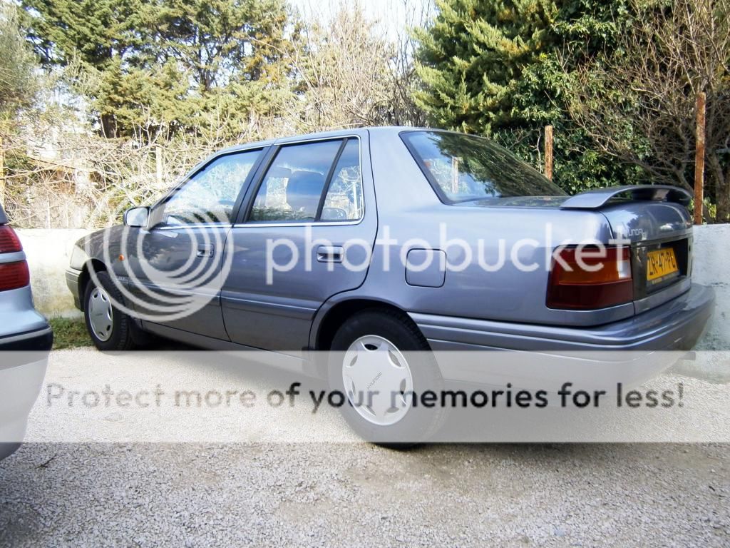

Meanwhile it has moved to south of France.
I recently changed the Original 1990 tyres for new ones, about time I think.
And found a new pair or Monroe gas shocks on ebay in total of 64 euro's !
Both front and rear.
That is the great thing about old cars you can find nos. ( new old stock)
My other car is a Volvo S80,but most of the short trips to the supermarket are done on a scooter or my excel
The first owner had given an anti rust protection.
Well there is now rust at all, every connector is stuffed with grease and this way a car can survive.
I have al the documents with it and the Original bill aswell.
It is not exiting as a car r but it feels nice to keep it in a good state and make people stare at an excel for crying out loud !!
