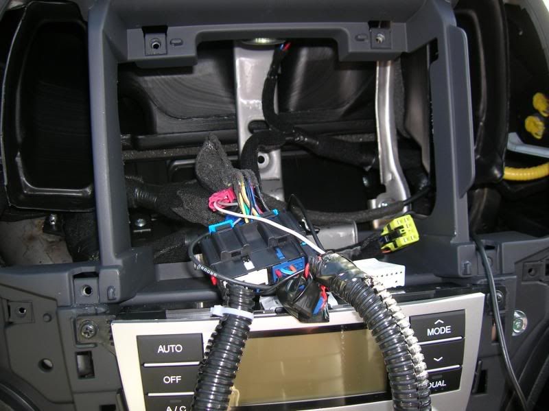

I found one of my older photos that may help. If you look you can see the a white wire (on the right) going to a red splice (red ones are for smaller wires), that connects to the GRAY wire on the santa fe side.

I have mine spliced on the Santy side of the harness, the same as yours. Still can't seem to get it to work properly though. Any other suggestions?
