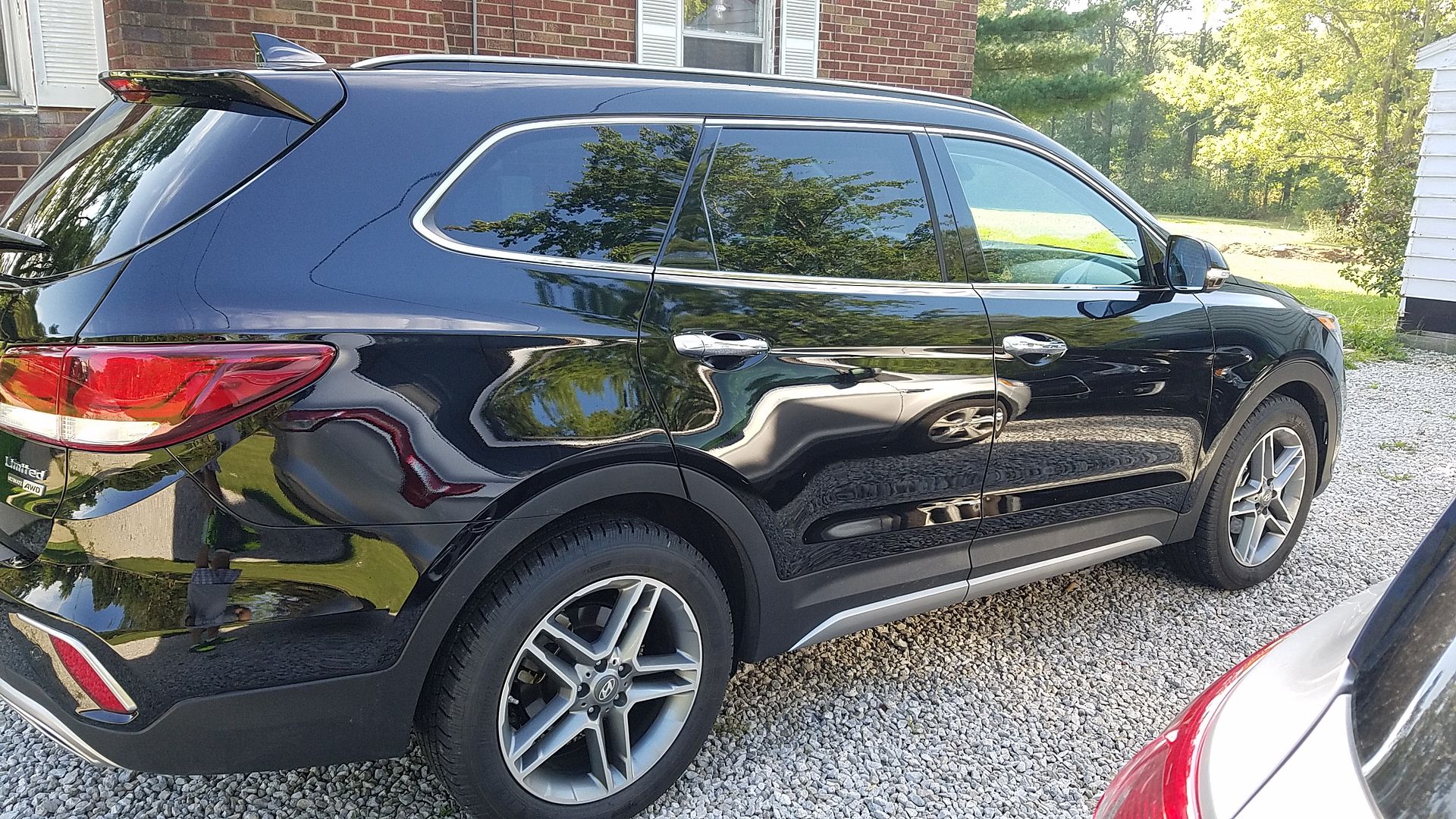

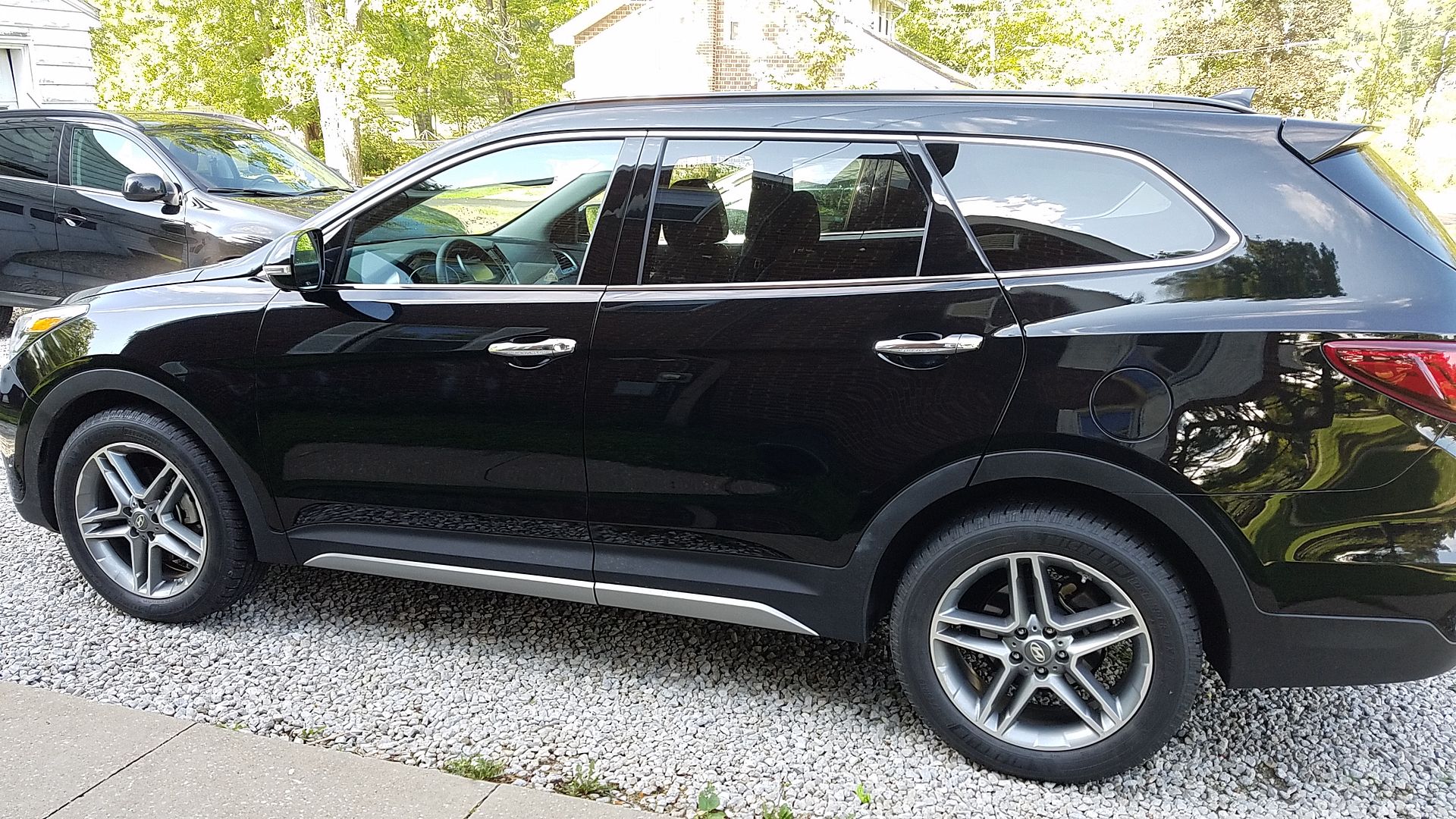

Were on our 3rd Santa Fe (09, 13, 17). All have been 3rd row/LWB variants. With each one ive noticed the rear suspension lacks when it comes to aupporting any sort of load. Were not talking about overloading here either. Just Filling the car with the amount of people its advertised to handle.
Ive only come across 2 solutions. Firestone airbags, and sumo springs/coil spring spacers. Neither really excited me.
I researched, compared, emailed and came up with what seems a legitimate solution. Hyundai Veracruz rear springs! Per Hyundai specs, the comparable springs (AWD model) were around 0.5 inches taller. The GVWR for the veracruz is about 500 lbs more so common sense tells me the springs would be stiffer, albeit slightly.
I emailed Hyundai. After 3 weeks of no response i called and was told to contact my local dealer for spring rate info. Yeah. I work for the local dealer . Hyundai doesnt publish speing rates.
So i pulled the trigger, and figured at worst i gotta eat the restock fee.
They work. Pictures to follow shortly.
There is a definate improvement in how it rides, and currently it sits 1.5 inches higher in the rear. I do expect it to settle in at around an inch over stock. More reviews to come once we get it loaded up a bit. I dont expect it to be perfect, but its gotta be better.

Very nice and detailed pics, Thank you for the pics and yep it looks a lot better and more importantly is what you wanted. Great job!!

Its nothing short of amazing. I expected a little harshness over the bumps/rough stuff, but its not at all.
The bounce is VERY minimal and overall road manners are improved. The car feels much more planted and balanced in corners.
Simply put, this is how Hyundai should have set this up from the factory.
Additionally. I did swap out the factory kumhos for Michelin defender LTX. Obviously some of the improvement is a result of the tires, but the greater difference comes from the springs.

Can you post two full body shots showing front and rear wheels together? I'm curious of how it looks compared to the front.
