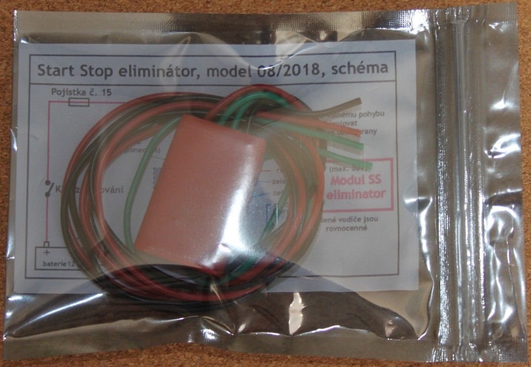

Option 2: Create a custom plug and play wire harness for Shark Racing ISG module or the TR-7/relay/resistor solution. If one purchases the correct wire connectors and pins, a custom harness can be built so that either the TR-7/relay/resistor solution, or the Shark Racing ISG solution can be installed without tapping into existing wiring. With this option, a short custom made wire harness is made which is used for wiring in the TR-7/relay/resistor or Shark Racing ISG solution. The new custom harness is inserted between the existing console top harness and the back of the console ISG switch (a 24 pin connector). This requires the user to build the custom wire harness.
I sourced my wire connectors from different vendors only because I could not find one vendor who would sell both the male and female connector in a quantity of 1 or 2 (some require 1000 connectors as a minimum purchase). Purchase the connector and the associated pins as listed below (or find your own source using the part numbers below). Since the TE crimper tool for these pins is over $1000, I did not crimp the wires. Instead, I very carefully soldered the wire to the pin, using a minimal amount of solder and then inserted the pin into the connector housing. This is a bit tedious but was worth it to me so that I did not have to cut OEM wiring or harnesses.
The connector is a 24 pin connector, with 18 pins populated in the connector (for the Ultimate trim, other trims may use less wires/pins). 14 of the 18 pins are a straight passthru (from a male to a female connector), and the other 4 wires need a straight thru with about a 6" pigtail (for connecting the Shark Racing module or the
TR-7/relay/resistor) off that straight thru wire. I stripped a short piece of insulation back and soldered a short pig tail, then heat shrink the solder connection on the 4 wires as indicated: Pins 1, 6, 13 and 23 require a pigtail for attaching either the TR-7/relay/resistor or Shark Racing ISG solution. Pins 3, 4, 5, 7, 8, 10, 12, 15, 16, 17, 18, 19, 21 and 24 are all passthru. Pins 2, 9, 11, 14, 20 and 22 are unused and are not needed (for Ultimate trim, other trim levels may have additional unused wires/pins). I recommend 22awg or 24awg wire. Length of wire between connectors is about 8" (so need a male and a female pin on each wire) When I built my original
test harness I made it much longer so I could test things while standing outside the vehicle. The entire custom harness should be less than 12” long so it will easily fit into the console cavity.
NOTE: A pigtail on Pin 23 is needed only for the Auto Hold solution. If you are only installing the R-7/relay/resistor for the ISG, then Pin 23 can also be a straight passthru.
440226
This diagram is for TR-7/relay/resistor solution using a custom wire harness so no OEM wires must be tapped, cut or otherwise altered. This creates a plug and play solution. Be sure to include a resistor in the solution.
Custom Harness connector pins and connector housing (male and female)
Console Switch Connectors are 24 Pin TE Connectors which are from te.com. I found it best to purchase individual housing connectors and pins from 2 vendors so I could purchase small quantities as needed.
-- Female Console Switch connectors:
----- Connector: 1376103-1 uses pin 1376109-1 (need 1 connector and at least 18 pins, I recommend purchasing some spare pins)
---- I ordered mine from Allied Electronics (https://www.alliedelec.com)
-- Male Console Switch Connector:
----- Connector: 1717112-1 uses pin: 1674311-1 (need 1 connector and at least 18 pins, I recommend purchasing some spare pins)
----- I ordered mine from Online Components (https://www.onlinecomponents.com/)
TE.COM sells wire crimpers for attaching the wire to the pin (before sliding the pin into the connector). However, the crimpers are over $1000 to purchase so I soldered the wires to the pins. This is probably the most challenging part of the custom wire harness as one must use a very small amount of solder, and manually crimp the wires tight enough to still be able to get the pin into the molded male/female connector.
Option 3: Install the Shark Racing module on the Console Top harness instead of the main floor harness. The Shark Racing instructions provide information to tap into the main floor harness. This harness is quite involved (over $1200 to purchase from dealer), and if one needed to replace it there would be significant work to do so.
This option allows the user to install the Shark Racing Module into a much smaller wire harness – the small harness within the Console. Use the following table to install the solution appropriate wire in the console top wire harness (closer to the actual ISG switch). The smaller console wire harness could easily be replaced (if ever wanted or needed) for about $100. This optional method is as simple as removing the console top (already documented). Since both the main floor harness and the console harness can be seen with the console top removed, one can trace the wires from the main harness to the console harness. Or reference the chart below for the wire/pin number and wire colors in the console harness. Attach the Shark Racing ISG modules as follows if attaching to the wire harness on the console top:
440227
Option 3a: Wire the Shark Racing ISG module into a custom harness (described above in Option 2).
