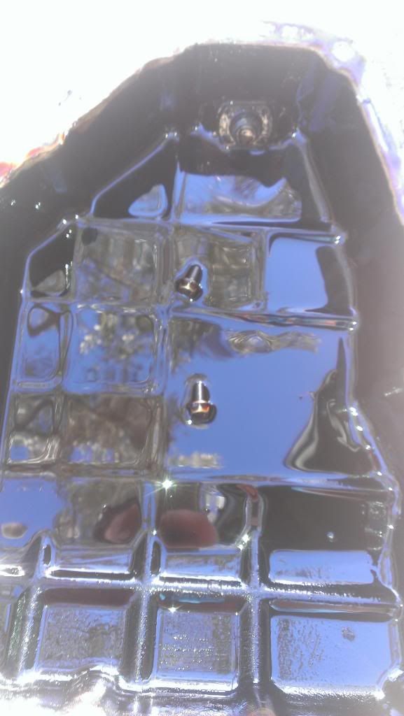

So 4 year and 90k miles later and my pan starts leaking again. So I took it off today and what do I find is 2 bolts laying in the bottom of the pan. I couldn't find what they went too either. I would assume someone at Hyundai didn't torque something right a few years back.
Also I stripped some threads in the upper pan anyone have experience on how to fix?

6mmx1.00 Heli-Coil kit for the pan bolt holes, other wise it be approx $350 for the upper pan chunk if that wher the goofed holes is, or price of ne front cover and labor/gaskets there.. the bolts, look around, there not much underside above the pan that I recall (you would think I would know having short blocked a LAMBDA this past summer).
May want to try and look up in the chain area too, see if guide rails have the bolts in them to front of block, rough to see in the though, dont know if able to.. we have a camera on flex with monitor for sneaking into areas..
When you put pan back onto engine, bolt torque at 54 in/lb is all you need.... take tap and clean out all the holes to of past RTV debris so bolts spin into clean holes

You could try 1/4-28 bolts of the right length. No tapping required if is going into aluminum. Just don't over tighten. May be a cheap way to fix this. I've done it on trans pans before on Fords.

Thanks for the response. I never had good luck with heli coils but I'll give it a shot again. I really have no choice unless I want to get a hole new cover. I looked up in the engine and couldnt find where the bolts came from. I will barrow my buddys Camera when I take it apart again to redo the threads.

Wishful thinking LOL. The big question is how long the bolts have been there.

Do the bolts in the bottom of the pan match the bolts that hold the pan in?

If the pan gasket had previously been replaced it is highly likely that these bolts did come from the group of bolts that held it on. (And the mechanic story sounds plausible.) As they are not going anywhere and if everything else is OK, I would stop worrying and put the oil pan on and refill it with oil and go about your business. There is no way I can see how they would get sucked into the engine. They look like pan bolts to me judging from their appearance.
Definitely not rod nuts.
Not sure what you mean about stripping threads in the "upper pan." (What is an "upper pan?") The bolts thread into the block don't they?

no they are not rod bolts. LOL and the oil pan is a 2 pc.
