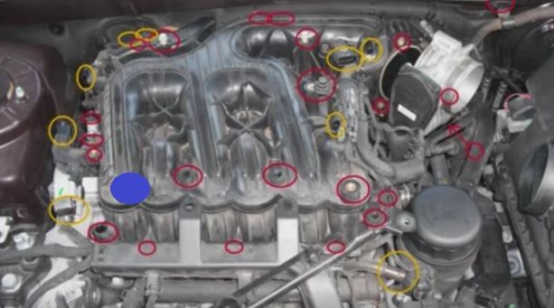

17,552 Posts
In that write up.. took way too much apart... too many loose single pieces.
Sorry for resurrecting such an old thread but I found the discussion to be quite helpful. sbr711, Would you mind on elaborating on what doesn't need to be removed in the FLUIDs blog post? I plan on tackling this job closer to the summer and do not want to remove anything more than whats necessary. Thanks!

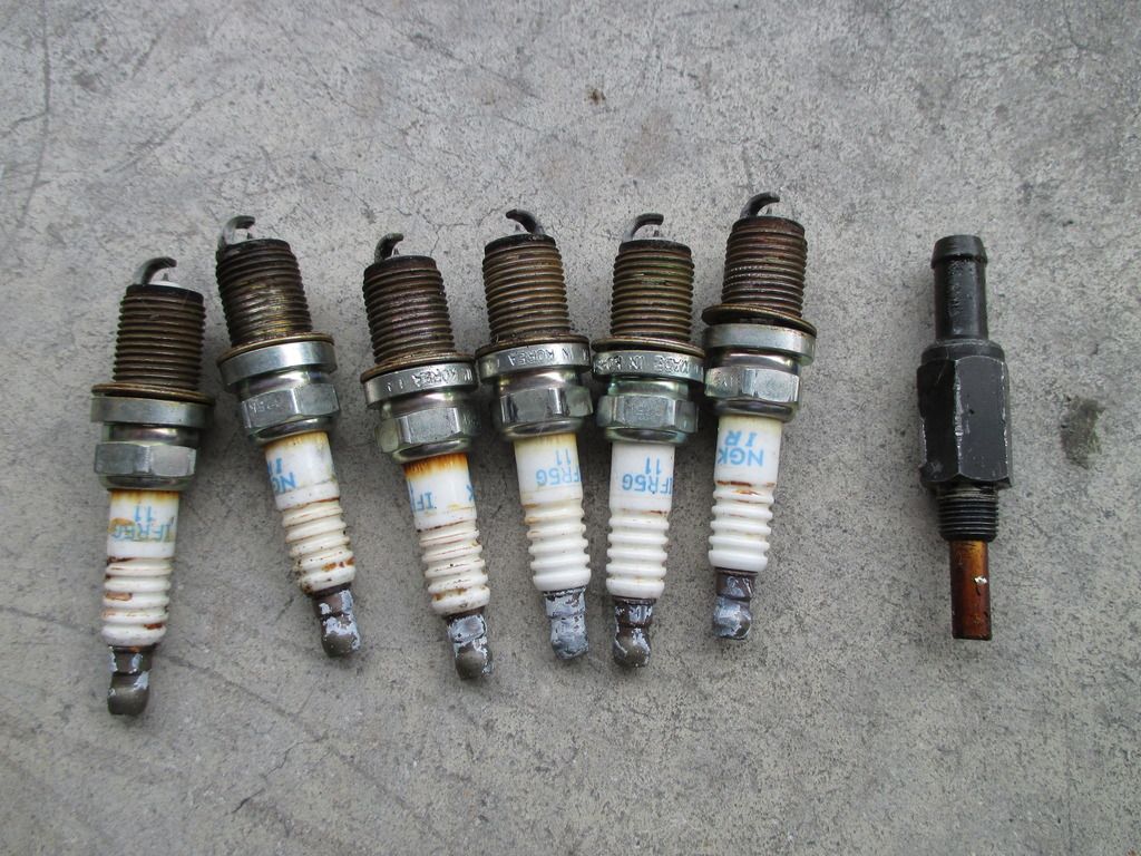

Well, I am nearing 200K so I needed to do the tune up. Did it once at 100K.....but jeez so many quirks went wrong during the swap yesterday. Took me 4 hrs lol like a true knoob.
1 one of those four I used trying to figure out how to remove that dang clip on the spark plug boot. The video of that guy on youtube with the burgundy 07 shows it best. The thread from fluid blog is also good, but when re-reading it and looking back at how I did it, Sbr may be correct in stating there are a couple of things that does not need to removed.
Next time this will take be 1 1/2 hours tops.

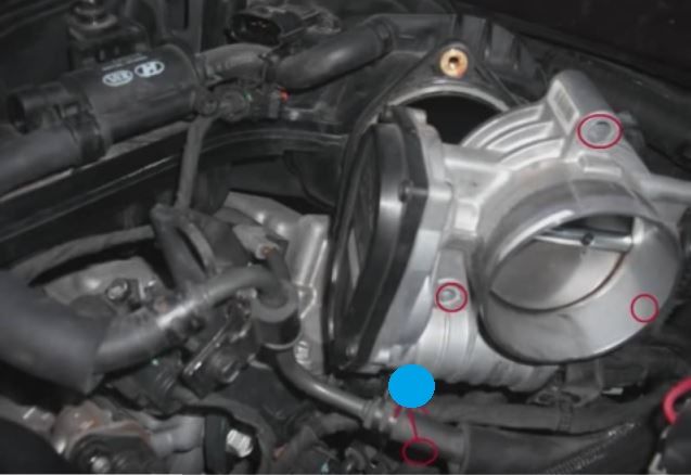

Which brings me to why I am posting: upon re-attaching the throttle body, there is that 4th bolt to the bottom left - it is much shorter than the other three long studs and uses 12mm instead of 10mm socket like the other three.
Could someone give me the part number for that? I dropped it while trying to secure the TB and I literally cannot find it. Thought it would drop to the floor but it looks like it's stuck sitting on top of some type of plate. Tried to look but I can't find it. It is pictured in solid blue in pic below.

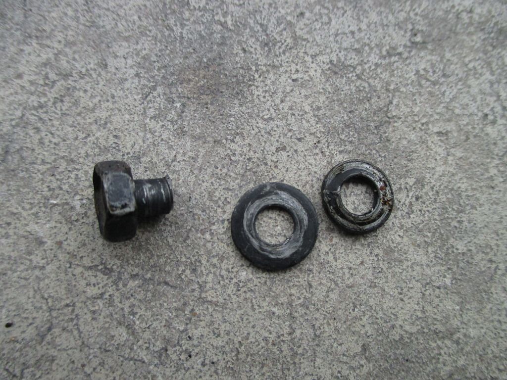

And lastly, when tightening the surge tank when I was done with the plug swaps, I cut one of the bolts so the stud is in the thread but the head is now missing. I think I can use the "grab it" tool I used on the famous rotor screw removal, but I would need a smaller bit for it. Luckily (I think), upon inspecting which bolt it is, it is not one that holds the surge tank down but it is merely to hold that metal rail...the rail has the thread to secure the engine bay cover. Either way I plan to take it out, I hope I didn't f*$k anything up. The bolt is the one in solid blue in the pic below.
