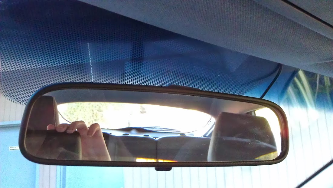

But anyway, over the weekend I got out my plastic tools and ran the USB power cord for my dashcam in the Accent. I tucked the cable into the headliner, ran it down the A pillar, inside the edge of the door molding, then under the dash across the driver's side, along the side of the center console tunnel, across the tunnel just aft of the gear shift knob to the passenger side, out that side of the plastic and then into the little accessories area on the dash where the 12 volt power socket is. I did this without having to remove any panels and only by fishing or tucking the wire. It did require a little bit of contortionism though when it came to securing a zip tie under the driver's side dash. Anyway, I'm reasonably happy with the results and no holes were drilled or anything.

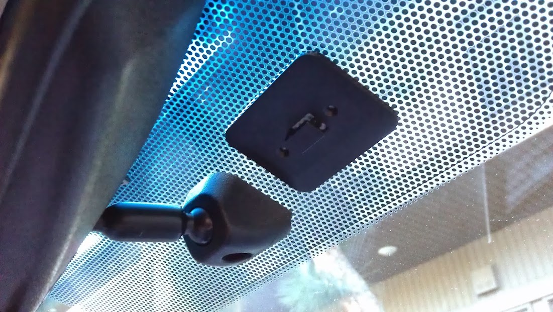

With that done, now I knew I needed to finally make that last bit of commitment and adhere the permanent mount to the windshield. I know for a fact it won't come off easily, so now that it's in... . Body shop guy really had to go after it on the Yaris to get my other mount (same 3M tape too) off of it after the Yaris was totaled. Anyway, there it is... done now. And I'm happy with the results.
From inside the car in the driver's seat, you can't even see the camera so you can't be distracted by it and a cop can't ticket me for having a "driver facing" video device since it isn't physically viewable (plus it's within the specified area where you can mount stuff on the windshield). From the outside, all you can see is the silver areas on the camera which I think I'll be taking a Sharpie to this evening.

I was using a suction cup mount with the above pictured camera, but it's a much smaller footprint when used with the more permanent mount. Plus, the 3M tape can go over the little sunscreen dots whereas the suction cup mounts want nothing to do with those little dots and you end up with your camera on the floor at inopportune moments... like in a hard right hander. Unpleasant results sometimes occur in those situations. ;)
