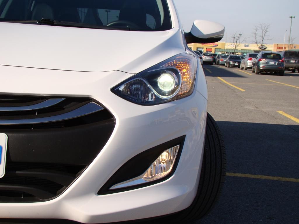

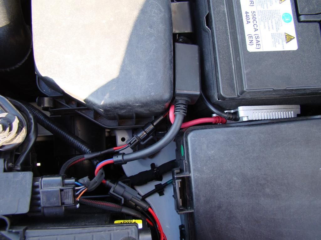

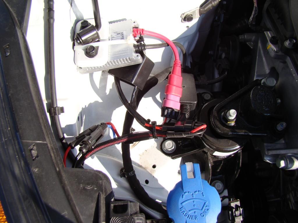

I installed these a couple of weeks ago. I used Xenon 5000k bulbs. At first, I just did the simple kit install, took about 20 minutes all together. But I soon found out they they didn't always come on, especially with the auto lights feature. So I added in the capacitor kit to each side and that solved all the issues. They now work flawlessly, no flickering whatsoever. The capacitors are a very simple 1 minute per side install, just plug and play into the ballast. The trickiest part of the original installation was running the harness through the dust cap. I ended up breaking off one of the vanes with a wire cutter then drilling a 1" diameter hole in it. The wire harness has a rubber grommet that fit perfectly, keeping the headlights sealed.
The cut off has not changed, the only real change is a brighter, whiter, crisper light output. It hard to see in these photos but you can get the idea. All in all, I'm very happy with them, would never go back to halogens. I had them on my last car for 6 years without any issues.
Wire harness on left side with ballast stuck between the battery and fuse box, capacitor between battery and air box:

Right side with ballast and capacitor wire tied under the hood support rod base:
During daylight, but you see the difference in colour:
A little darker outside:
