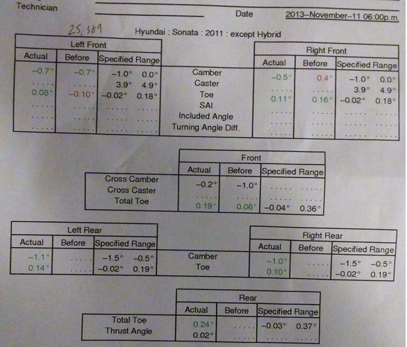

I just got my car aligned this morning and this was the result.
(Edit: Obviously I took it to get aligned because it wasn't in alignment, just to explain the before numbers. It had been a while.)
I wasn't sure why they left the left side cambers out of adjustment or if that was a normal thing. Should I check with the dealer about getting that adjusted back into the normal range?

Left front is going to push the car to the right something fierce,, 1.1 degree spread.. something tweaked at left front.. anything over 0.5 degree spread may start to make things happen..
Left rear.. why didnt the monkey adjust the left rear camber, let alone both camber down to minimum ??
I take the rear cambers down to -0.5 or -0.6 degree to minimze tire wear and minimize toe also, as long at print green to show it in spec..

The dealer replaced my strut and after a couple days gave the car back (this was a year or so ago) My tires wear is even but faster than it should be (tempted to blame "spirited driving") I wondered if to counter the pull they just adjusted that side a bit. The strut replacement seemed to fix the problem though. I just had this done this morning so I haven't driven it enough to see how it is. I'd like them all to be in the greens if possible though. Seems odd to leave them in red and call it a day.
(I have the firestone lifetime alignment, so I can take it back to them for free etc. I might stop in and ask why they left them in the red zone.)

Need to balance the front cambers to a less than 0.5 degree spread so front sits relatively balanced in the front so as to not to push to one side or other..
Maintain the minimal toe numbers, though squared to center line on rear, and dump them stupid camber numbers on the rear down to -0.5/-0.6 degree to keep from blazing the edges of the rear tires,, may find the car to handle a bit better and tires last longer..
Got VIN I can run for warranty claims/recalls ?

If it says the rear camber is not adjustable is there actually another way to adjust the rear camber? Someone in a post somewhere said it is actually adjustable but it's on the control arm or something. I don't have the VIN with me right now but so far I think I'm up to date with the recall stuff.
