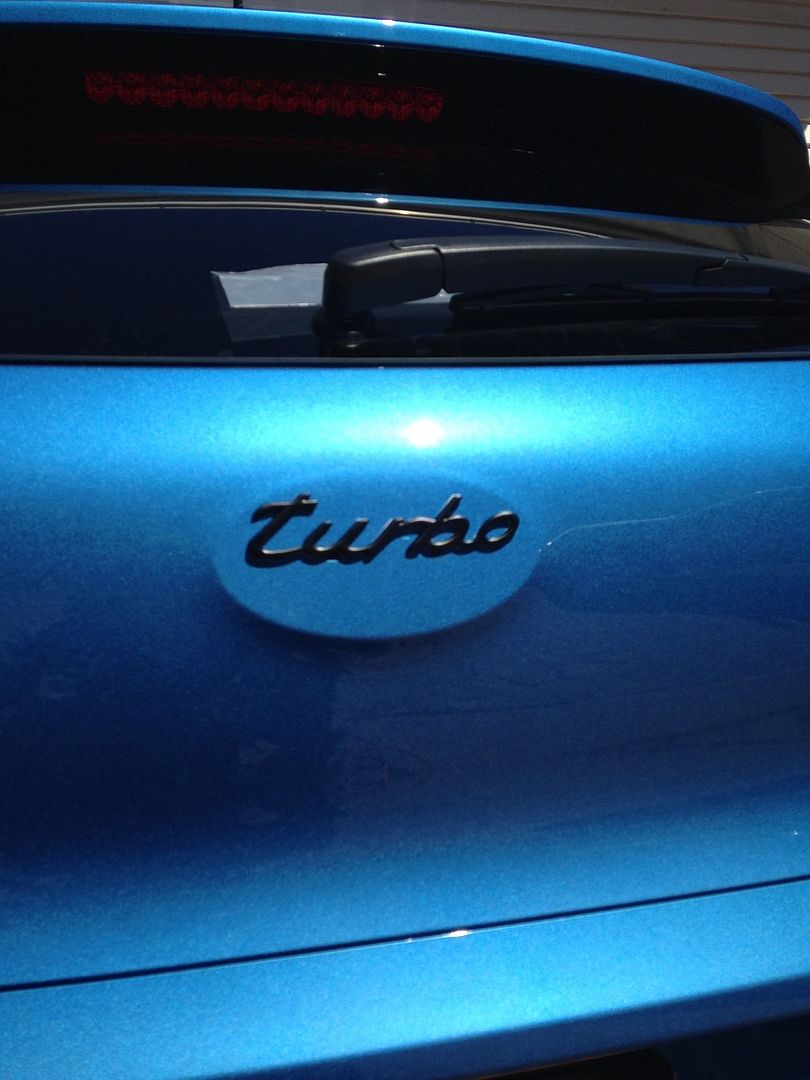

So i pulled the trigger on deleting the rear hyundai badge despite the holes in the rear hatch.
Solution, stickers.. So i found some clear laminate and covered the badge holes. Sorry i didn't take pictures of the rear deck clean. It didn't look to good so i followed through with plan b. Black $7 porsche macan turbo badge.
the badge covers the holes pretty well
the bevel in the rear hatch kills the totally clean look so for now i will keep the badge
badge looks so-so not really sold on it yet
the badge posts, the floss is for reference in size
