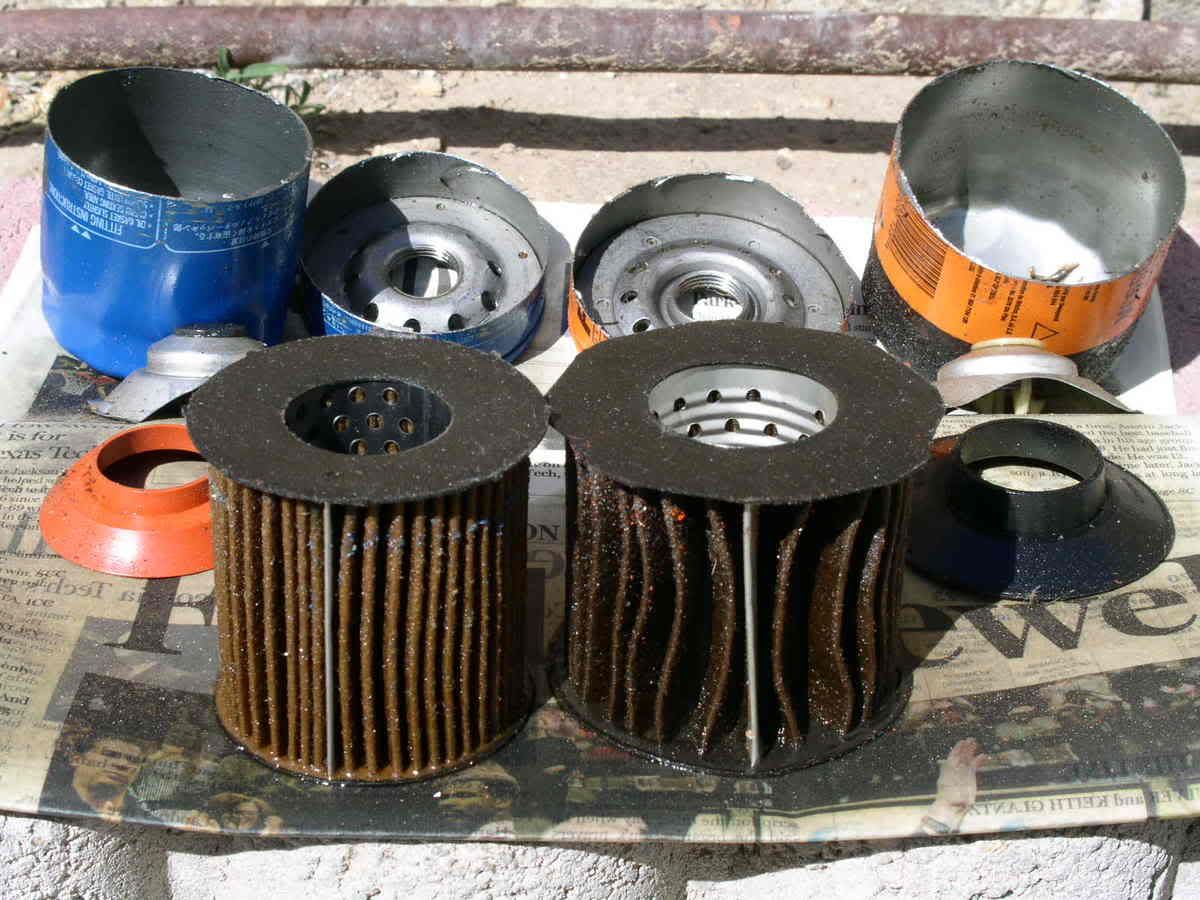

not all filters are built the same. no, there wont be any difference felt when driving - and anyone who tells you they do feel a difference are lying and or on sugar pills. BUT since not all filters are built the same, the true benifit is longevity of your engine. since filters, FILTER, and since some are built better - some can last longer, filter smaller microns, and or simply provide a higher quality filtration all around.
take a look for yourself! same filter size(same car), but take a look at the small amount of FRAM pleat count, metal to cardboard construction, anti drainback valve, etc compared to the others:
MODERATOR
2,258 Posts
HONDA FILTER (left) FRAM FILTER(right) - check the pleat count

looks like from this test on 2010, hyundai had a nice filter!
