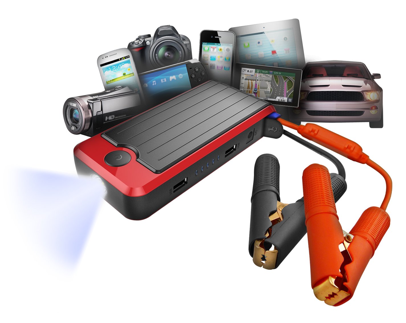

This charger has been tested an works quite well. One guy started over 20 cars with it for a single charge and can be used to power many other things.
Amazon.com: PowerAll PBJS12000R Rosso Red/Black Portable Power Bank and Car Jump Starter: Automotive
That thing would make me nervous. Lithium batteries are still not the most stable things to have around. Especially big ones- that's no tablet battery.
Apart from that, I can't see it lasting very long before the battery needs to be replaced- and it looks like you can't replace the battery so that's a whole new unit.
I have an older AGM style battery jump pack. It's bigger, heavier, less convenient etc. But it will hold more 50% more total power, make more of it available at freezing temperatures, cost roughly the same to buy, and I can replace the internal battery (every 4-5 years) for about $30. And all without the lithium fire risk.

You guys. A couple of Teslas burn to the ground and a few new Boeing planes have to make emergency landings and you worry about Li batteries. Just what about that phone in your pocket??????
