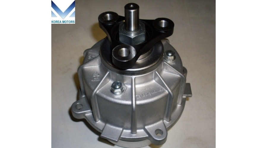

It can be rebuilt..it's a bearing issue
Thats not the same model at all. In the video its a electro-magnet, we have a multi-disc viscous coupler with a hydraulic pump.
And its not the same problem too, in the part 1 of the video, his customer is complaining about a whining noise following road speed (bearing problem..), not about a knocking noise when turning corner.

electro magnetic, believe it's a Borg Warner
