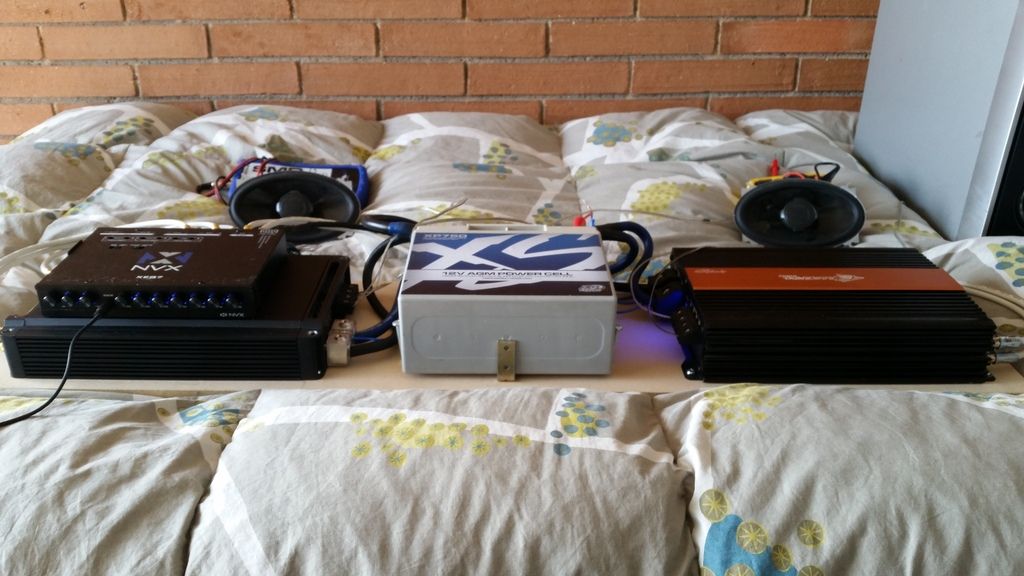

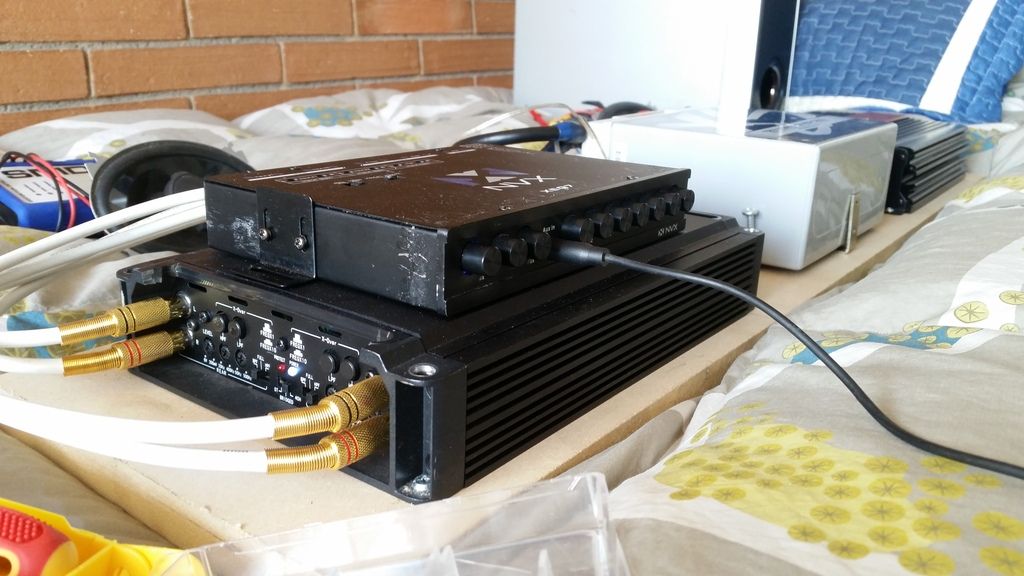

While I had the amp rack in my room I did a test with a set of coax speakers and a small sub lol
My plan is to take the wires coming from the headunit to the stock amp and connect them to the equalizer so it divides the signal in front, rear and sub stage.

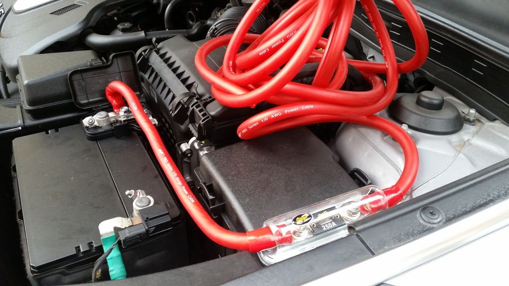

Yeah, it's the easy way, but there's another benefit, I won't have to worry about signal wires getting in the way of power wires... So less chances of having noises induced into the signals
13,336 Posts
until a chunk of metal from a truck hits it, frays the insulation and your 250A ANR takes out your battery before it blows.
With the size wire you have, noise issues are minimal. Do yourself a favour and wire it through the passenger compartment where it won't blow up the battery.
135 Posts
Have to agree with Steampunk... route that under the inner door sills. Those zip ties will dry out and break in short order and cause problems if road debris doesn't get you first. The tiny % of noise that you are going to get by running it alongside signal wires (which should be run down the other door sill) will be easily masked by road, engine and wind noise.
