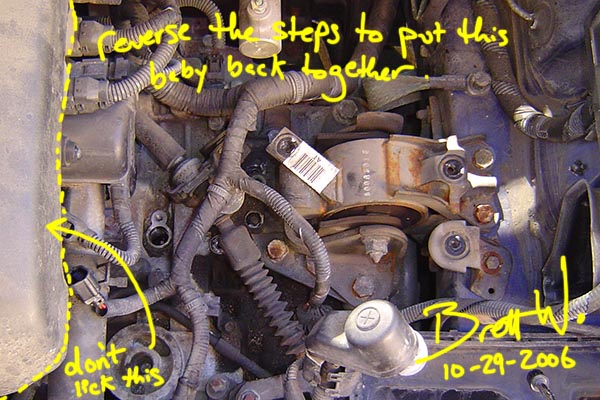

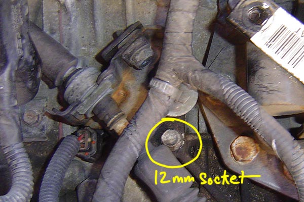

Hey guys! First real post here..
I had some trouble with my Hyundai 2001 Elantra GT recently. Just after my 60k mile bumper to bumper warranty was up I started getting a P0715 and P1529 troublecode. The real deal is the P0715 which is the Input Speed Sensor on the Transmission. I would clear the codes with a scan tool and they would come back usually within 30 minutes of driving. When the check engine light comes on the car locks itself into 2nd or 3rd gear.. mine always seemed to be 3rd gear. At first I thought it had to be a loose cable, but I just ended up replacing the sensor and everything seems great now.
I took a bunch of pictures for anyone else with this problem, it's really simple to fix if you have a couple tools (philips screwdriver, 10mm and 12mm sockets with extensions, 10mm wrench, dentist like pick, air compresser or can of compressed air, and a magnetic pickup tool is helpful).
I purchased the $50 vol. 1 service manual for my vehicle and it really doesn't help you much in the replacement, or even location, of the input speed sensor (to the transmission). It just has a quick one-page flow chart to diagnose the problem if you are seeing the P0715 code. Actually, if you are seeing this code, more likely than not the dang sensor is bad. These hall-effect magnetic pickup sensors seem to be a good source of income for dealers because they fail like crazy. There does seem to be a life to them though, but consistently after 60k they seem to either go bad, or hang on for a while longer. My dealer said they replace them constantly. Anyhoo, save yourself the $50 for the manual and just get the $66 sensor.
Here we go:
(IMG:http://www.everybodytothelimit.com/p0715/dtc_p0715_repair_01.jpg)
(IMG:http://www.everybodytothelimit.com/p0715/dtc_p0715_repair_02.jpg)
(IMG:http://www.everybodytothelimit.com/p0715/dtc_p0715_repair_03.jpg)
(IMG:http://www.everybodytothelimit.com/p0715/dtc_p0715_repair_04.jpg)
(IMG:http://www.everybodytothelimit.com/p0715/dtc_p0715_repair_05.jpg)
(IMG:http://www.everybodytothelimit.com/p0715/dtc_p0715_repair_06.jpg)
(IMG:http://www.everybodytothelimit.com/p0715/dtc_p0715_repair_07.jpg)
(IMG:http://www.everybodytothelimit.com/p0715/dtc_p0715_repair_08.jpg)
(IMG:http://www.everybodytothelimit.com/p0715/dtc_p0715_repair_09.jpg)
(IMG:http://www.everybodytothelimit.com/p0715/dtc_p0715_repair_10.jpg)
Pictures continued in next post...
This post has been edited by Brett777: Oct 29 2006, 05:55 PM

Wow. That is probably the best DIY I've ever seen. Great job! :banana:

Thanks! I'm an electronic engineer, so I pay attention to detail ;) I would have liked to do more for this tutorial, but there are only so many hours in the day. I also saw what was out there and felt obligated to share what I've learned so others can find the info easier.
Feel free to post this around wherever it's appropriate, and if anyone wants to add to it please do. I have larger pics also if necessary, but these should be plenty good.
Link-backs to this post would be appreciated also. I'd like to see if people find it useful. There are other things I want to do to my car in which I may do similar write-ups in the future.
Ok, enough blabbing.. :beer:
